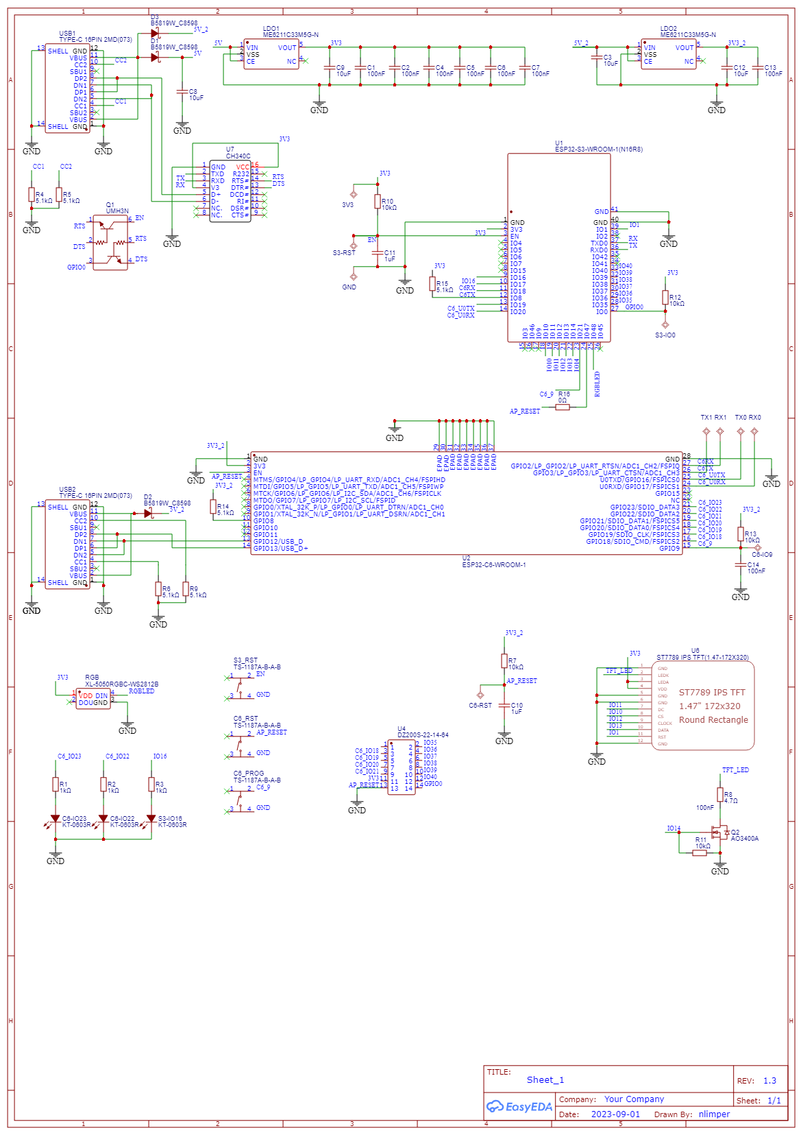

This is a Access Point for the OpenEPaperLink project, using a ESP32-S3 and ESP32-C6. Includes an interface port to flash your tags.

Basicly, this is a universal WiFi <-> IEEE 802.15.4 gateway, with a size smaller than a credit card. The Access Point is powered by USB-C cable (not included)

The AP is based on an ESP32-S3 and uses a ESP32-C6 as a radio interface. With the OpenEpaperLink software, the system uses unencrypted, Zigbee-like (IEEE 802.15.4) packets on 2.4Ghz. Thanks to a web-interface on the ESP32-S3, the accesspoint is fully self-contained to works together with electronic shelf labels that run the OpenEpaperLink firmware.

I you want to tinker a bit more: On the pcb, you will find a footprint for an optional CC1101 module (not included, you can get it at Aliexpress) or a Ebyte E07-900M10S module (not included, you can get it at Aliexpress), which reportedly has a higher quality than the cheap CC1101 modules. You can place it in case you use tags on the SubGHz (868/914MHz) frequency range, like the Chroma type.
