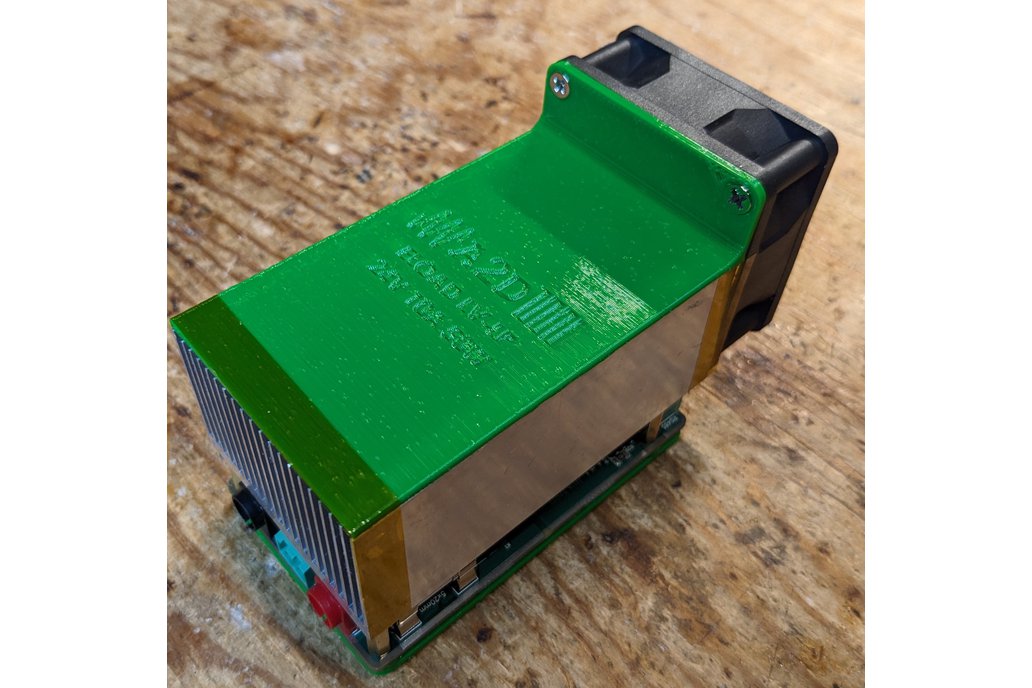

What is it? This board was designed as a simple programmable electronic load (eload) for discharging batteries for computer-controlled single-cell tests. The goals was to do 1 thing pretty well – con…
Read More…This board was designed as a simple programmable electronic load (eload) for discharging batteries for computer-controlled single-cell tests. The goals was to do 1 thing pretty well – constant-current discharging for Low-Voltage, Low-Power cells.
Through my years of battery testing, I've seen a lack of cheap, reliable, simple-to-use programmable eloads. No one want to sit watching a battery discharge with a manual testing unit, and for cycle testing it needs to be computer-controlled.
I did not add extra features such as a high output slew rate or extra measurement ports, as this will be controlled by a computer that can have other devices hooked up for that (such as the A2D 4ch Isolated ADC). There is no front-panel interface either to keep complexity and cost to a minimum, and all control happens through a SCPI interface on the USB port. Examples to get up and running with a python script are provided (see the Communication section). Up to 32 devices can be controlled from a single USB connection by connecting the RS485 bus together.
The spec sheet is available in the links below, with full schematic, firmware, and python control software as well.
