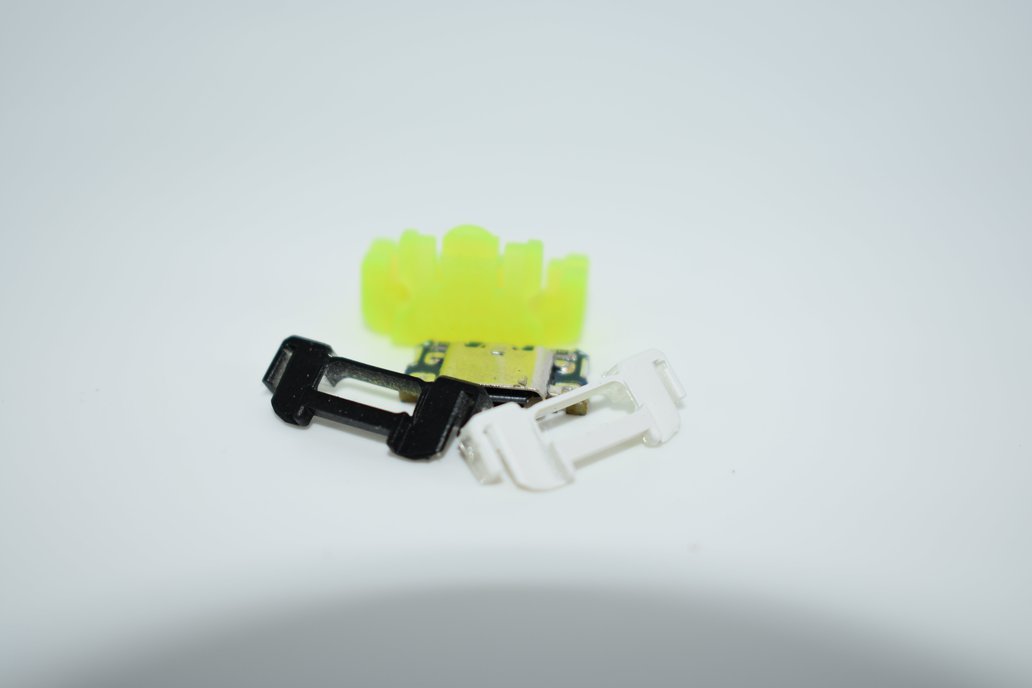

Place the USBC board into the resin jig (if not already in there) and then firmly slip the jig onto the PCB (the middle notch slips into the notch on the motherboard). Be careful not to flex the motherboard too much while also making sure it's pushed all the way on.

Grab the black or white bezel from the kit (whichever you think matches your case best), push contacts into the bezel (shorter leg goes through the top hole and longer L leg goes through the open ended hole). There may be some friction, I use a pair of tweezers to squeeze it through it's important that it's flush with the bezel.
With both contacts placed inside put the bezel on the USBC board while fitting it's L shaped legs into the left and right holes. Make sure the bezel is on and seated as far back as it can (no need to force it just make sure it's reasonably pushed back). Solder the L shaped legs on the left and right side.
