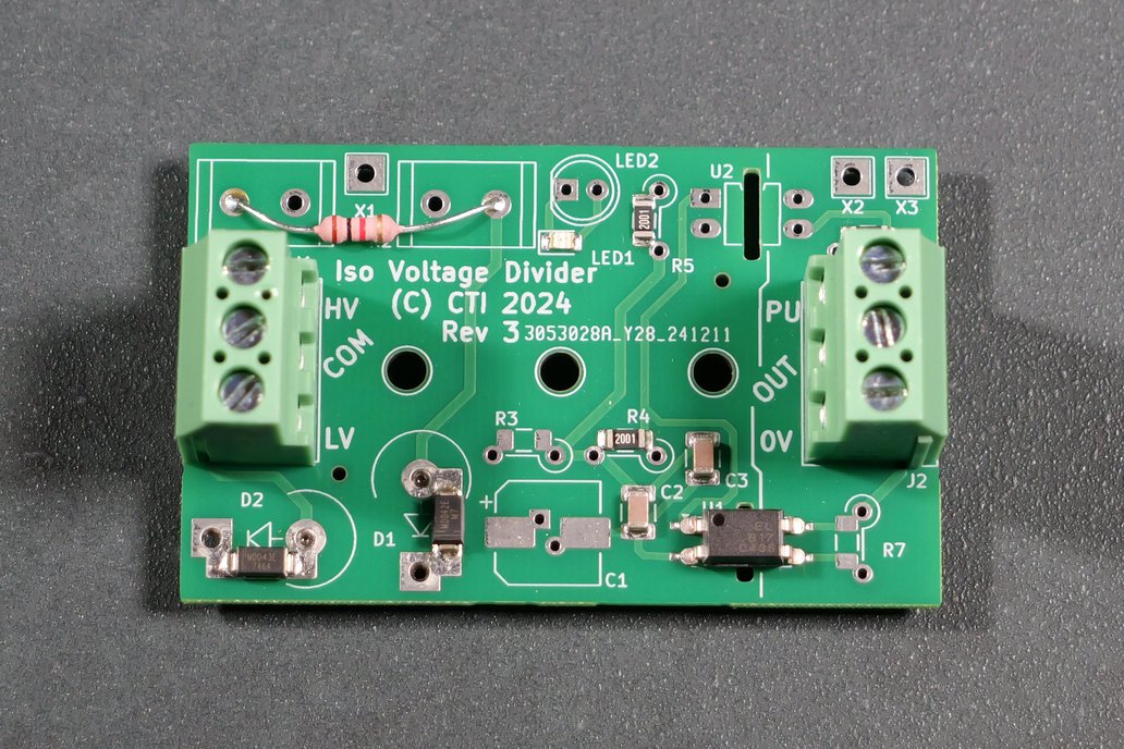

Read More…Note: the PCB has been updated, same circuit, same connectors / connections, similar form factor. See below for more details. Optically isolated interface board that allows a Raspberry Pi, Arduino, BeagleBone or any logic level digital input that works with the output of an opto-isolator and 10K pull up resistor to monitor a 24V AC/DC signal common in HVAC systems and on irrigation solenoid valves. It has a built-in LED to make it easy to see when a signal is active and screw cage connectors for easy hook up. It has a rectifier and filter capacitor to convert AC to DC and hold the output stable so the receiving microprocessor does not need to process a pulsating signal. Pictures show an actual unit on our DINVESA Plate connected to a 3.3 V PU and with a 24VAC transformer connected to the input in on and off states; the output gets pulled below .1 V when the 24 VAC transformer has power. Details on PCB update: the board and mounting holes were made slightly wider so the a DIN clip can be directly mounted to the board. Also most of the footprints were converted to hybrid through hole / surface mount formats that accept a wide variety of parts. Also expansion connection point have been added so a future multi-channel expansion board can be connected.
I often use a Raspberry Pi, Arduino or BeagleBone to monitor and control systems in agriculture and industry and wanted a versatile interface board that could be used in a wide variety of prototype and low volume situations. This is that board setup to accept a 24 volt AC or DC signal.
While this version comes setup for 24 volt signals, there are two large footprints on the input that allow use of resistors capable of dropping a wide range of input voltages. The mounting holes line up with a Phoenix Contact 1201578 Din Rail Adapter allowing DIN rail mounting. And a LED makes it easy so see if the input is active.
