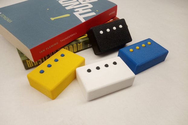

What it is? It's a fully assembled and programmed PCB with 2.13" e-paper display - a heart of Agora Clock or Agora Watch. But you can also create you own variation. For inspiration check my homepage:…
Read More…It's a fully assembled and programmed PCB with 2.13" e-paper display - a heart of Agora Clock or Agora Watch. But you can also create you own variation. For inspiration check my homepage: www.agorawatch.com
Just connect a bench power supply or a Li-ion or Li-pol battery and you have a working clock. Then you can start experimenting with firmware or just put it in some box and enjoy the e-paper display.
