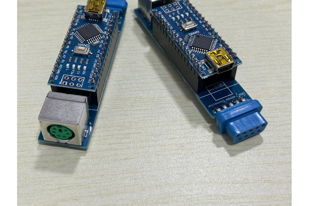

MSX Mouse Converter can convert IBM PS/2 standard mouse to MSX Joyport interface.
Designed by Denjhang's Retro Hardware in Malaysia
What is it? MSX Mouse Converter can convert IBM PS/2 standard mouse to MSX Joyport interface. Why did you make it? I want to run SymbOS on my Omega MSX2+ or uMSX, but lack a mouse. However an origina…
Read More…MSX Mouse Converter can convert IBM PS/2 standard mouse to MSX Joyport interface.
I want to run SymbOS on my Omega MSX2+ or uMSX, but lack a mouse. However an original MSX mouse is expensive and difficult to buy, so I found this on Google:

I will give away a MINI USB data cable. If you don't like the 2014 version firmware, you can upload the 2013 version firmware to the Arduino Nano by yourself. Older versions of firmware are easier to initialize, but do not support mouse wheel mode.
The current firmware of this converter is NYYRIKKI 2014 v1.1. This version of the firmware has the following modes:

1. When uMSX is turned off, insert the MSX mouse adapter into the JoyPort 2 of uMSX, and connect the PS/2 mouse to the MSX mouse adapter.
2. Press the uMSX power-on button, and then uMSX will boot up. Enter Sofarun and open \MSXSOFT\HIDTST2.com. Then you will find that nothing happens when you click or move the mouse. At this time, the mouse needs to be initialized.
3. Press and hold the right button of the mouse, then click the reset button of the Arduino Nano of the MSX mouse converter. Release the right button when counting to 4 seconds. When counting to 8 seconds, the TX light of the Arduino Nano will flash once, and then Quickly click the left mouse button and move the mouse. If the initialization is successful, the L light will flash and the TX light will flash, and then the L light will flash intermittently every half second. This is suitable for moving the mouse, the HIDTEST program will have a digital change, but the device type is not displayed correctly. Hold down the left and right mouse buttons simultaneously and move the mouse, then HIDTEST will show the mouse pointer and display the device as MSX Mouse. At this time, press the ESC key to exit, and then open \SYMBOS\SYM.COM to enter SymbOS directly. I have configured the system correctly, please do not change the configuration or driver.
4. If the initialization fails, the L light will not flash, and there will be no response when you click or move the mouse on HIDTEST, then please repeat the third step until successful initialization.
