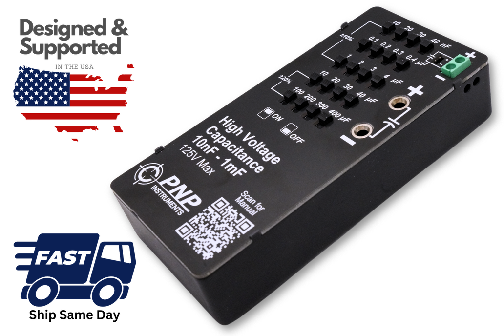

5 Decade Capacitance 125V 10nF – 1mF (High Voltage)
Designed by PNP Instruments in United States of America
The Five Decade Capacitance box has five decades from 0nF to 1mF. Explore precision with the high voltage 5 Decade Capacitance Box, ranging from 10nF to 1mF. Ideal for design, development, and educa…
Read More…The Five Decade Capacitance box has five decades from 0nF to 1mF.
Explore precision with the high voltage 5 Decade Capacitance Box, ranging from 10nF to 1mF. Ideal for design, development, and education, i Inductance range: 10nF – 1mF
Max DC/AC Voltage: 125V
Switch Resistance 100mΩ Max
Connector Options:
Unit Dimensions: 5.46x2.58x0.1.24" / 138.7x65.5x31.5mm
Unit weight: 7.5oz / 213g
Specifications:
Range | Tolerance | Max. Voltage |
10nF | 10% | 125V |
20nF | 10% | 125V |
30nF | 10% | 125V |
40nF | 10% | 125V |
0.1μF | 10% | 125V |
0.2μF | 10% | 125V |
0.3μF | 10% | 125V |
0.4μF | 10% | 125V |
1μF | 10% | 125V |
2μF | 10% | 125V |
3μF | 10% | 125V |
4μF | 10% | 125V |
10μF | 20% | 125V |
20μF | 20% | 125V |
30μF | 20% | 125V |
40μF | 20% | 125V |
100μF | 20% | 125V |
200μF | 20% | 125V |
300μF | 20% | 125V |
400μF | 20% | 125V |
