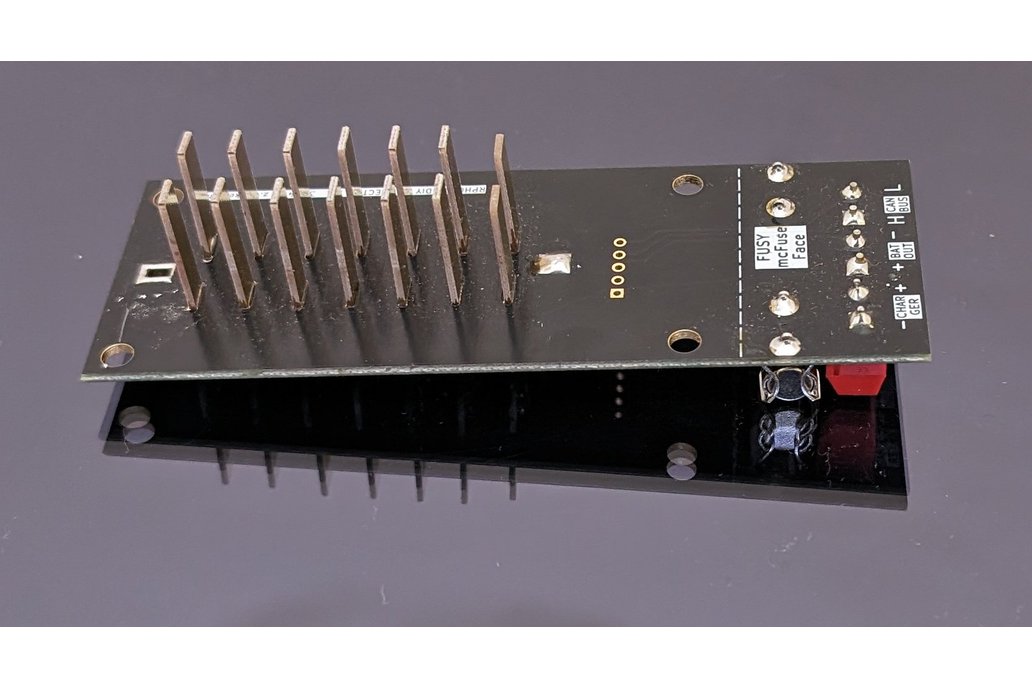

A handy DIY connector kit for RPH0002 batteries
Designed by Zwackelmann - Zauberei und Schindluder in Austria
The RPH0002 Batteries come in different Capacities and sizes. They are usually rated 47.2-48V and 14.8-16.8 Ah They are manufactured by OKAI and used in many rental scooters and rental Bicycles lik…
Read More…The RPH0002 Batteries come in different Capacities and sizes. They are usually rated 47.2-48V and 14.8-16.8 Ah They are manufactured by OKAI and used in many rental scooters and rental Bicycles like:
Those Batteries are sometimes for sale, but the connectors are hard to find. If you want to use the battery you will need to send CAN messages periodically. CANarchy can be used to do this.
The kit contains: - PCB black - PCBs green - 2pcs Screwterminals - 2pcs Fuse holders - 1pcs 10 Ampere Fuse
You need to send these CAN messages every few seconds to keep the Battery from resetting itself.
03FF1602#043B8F00002B0412 02FF2602#DDB8FB433D7049DB
The Battery talks at 250000kbps CANbus Baudrate
